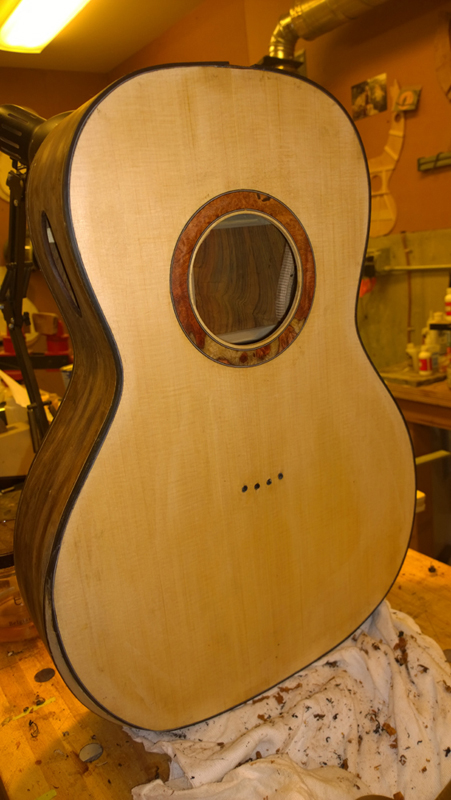

I am close to being able to start finish sanding my latest guitar. It has cocobolo back and top a wonderboard lutz top both top and back bought from the classified section. The rosette and heel cap are amboyna burl. Bindings and fret board are ebony. I used a bit of african black wood for the end wedge as I did not have a scrap of ebony.

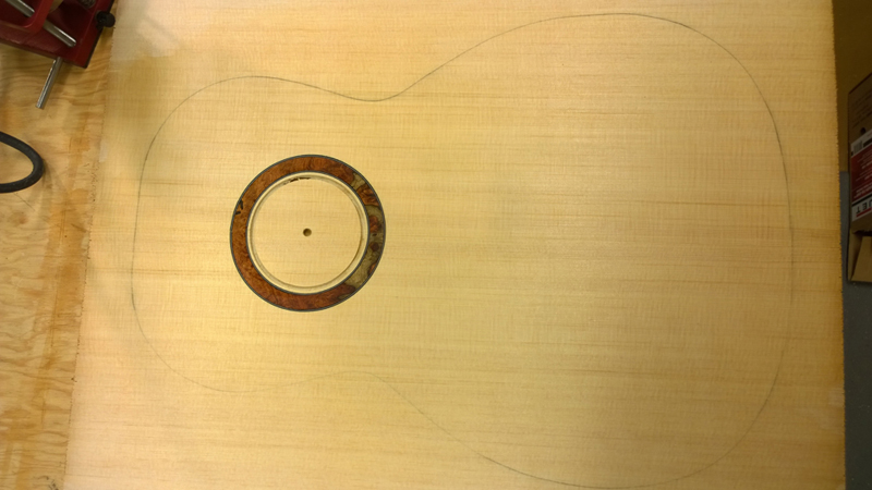

Thank you guys for the supportive comments. This is a commissioned guitar. I had planned to use a more traditional X-brace, but I so love the sound of my first falcate, I decided with the customers input to make it a falcate as well. Cal, if you can get the equations you need into excel (for me calculating the plate thickness) you can gloss through a lot of the derivations. As I followed Trevor's design in my first falcate the design decisions were already accounted for.
There are quite a few of use using falcate bracing, it would be nice to have a sub-forum. I may have been lucky on the first, but the sound and performance of my first falcate is so much better than any of my other guitars that it is almost like cheating for an inexperienced builder like myself to be able to achieve it.
Wes, your OM looks great, I have yet to do string by string nut compensation, only taking a baby step by taking a bit off the fret board from the zero slot.
Ernie, I plan to use zpoxy to pop the grain although I am considering using the west system epoxy as it does not have the amber tint. The cocobolo darkens with finish, maybe the water clear west system will pop the grain better.
Bob, Here are some rosette and headstock pictures. The rosette is amboyna burl and the head stock is from the back cutoff.
